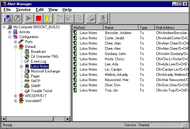

To send an Alert message to a Lotus Notes user
- Highlight the Lotus Notes leaf object to display the current Lotus Notes settings on the right side of the Alert Manager.

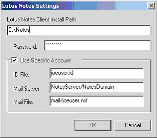

To set the configuration settings for the Alert service
- Right-click the Lotus Notes leaf object to bring up the context menu and select Lotus Notes Settings. The following screen is displayed.
- Enter the path where Lotus Notes client is installed.
- Enter the client password.
If you want the service to switch to another User ID, check Specific account, and supply the next three fields:
- ID file [for example, joeuser.id]
- Mail Server [for example, NotesServer/NotesDomain]
- Mail File [for example, mail/joeuser.nsf]
Click OK upon completion of these steps.
