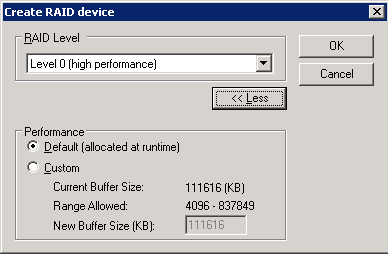

- Select the RAID Configuration from the list, choose Properties, and click More. The Change RAID properties dialog opens.
- In the Performance area, select one of the following options:
- Default--CA ARCserve Backup calculates and applies an optimum value.
- Custom--Enter the buffer size in the New Buffer Size (KB) field. For example, to create a buffer size of 150 MB, enter 150000.
- Click OK to close the dialog and save your changes, and then close the remaining dialogs.
