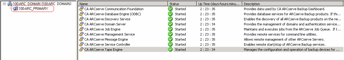

    2. From the server tree, locate and select the primary server.
      The CA ARCserve Backup services appear in the right side of the window.
      Illustration - Server Admin Manager. CA ARCserve Tape Engine is highlighted.
    3. Right-click CA ARCserve Tape Engine and select Stop on the pop-up menu.
