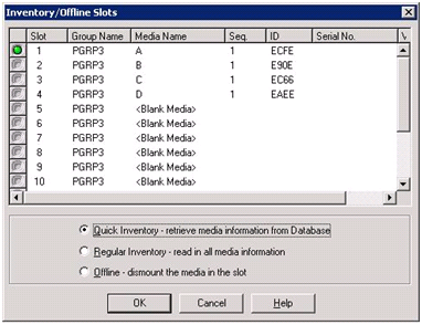

  1. Right-click a slot and select Inventory/Offline Slots from the pop-up menu.
    The Inventory/Offline Slots dialog opens.
    Inventory/Offline Slots dialog. Regular Inventory - read in all media information is specified.
  2. Select the slot you want to inventory. Press the Shift key to select multiple contiguous media. Press the Ctrl key to select multiple non-contiguous media. The light icon next to selected media turns green.
    Note: You can also click and drag the light icon to select multiple contiguous media.
  3. Choose one inventory method:
  4. Click OK.
