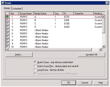

    The Erase dialog opens.
    Erase dialog. Quick Erase - only destroy media label is specified.
    Note: Slots reserved for cleaning media do not appear In the Erase dialog.
  2. Select the slot you want to erase. When you select media, the light icon next to the media turns green.
    You can press the Shift key to select multiple contiguous media. Press the Ctrl key to select multiple noncontiguous media. You can also click and drag the light icon to select multiple contiguous media.
  3. Select an erase method, click OK, and then click OK to confirm.
