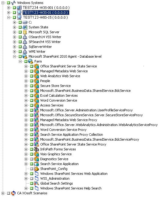

Use the Backup Manager in CA ARCserve Backup to perform database-level backup on SharePoint 2010 systems.
To perform a Database-level backup on SharePoint 2010 Systems
The Backup Manager window opens.
