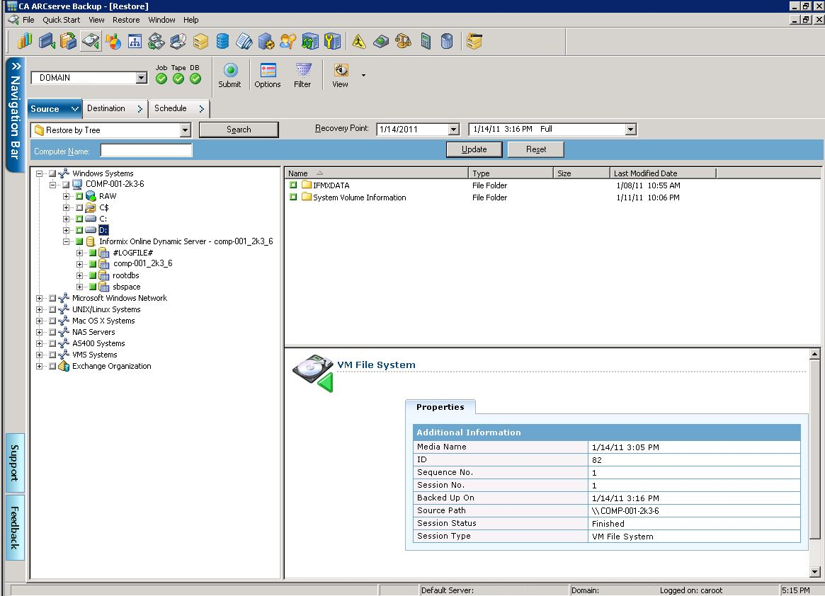

You can restore an IDS database including logical logs, dbspaces and blobspaces.
To restore an IDS database
Note: Only one dbspace can be restored at a time.
Note: Do not restore the #LOGFILE#. The Informix server restores the logical logs automatically when a logical restore is performed.
The Restore Options dialog opens.

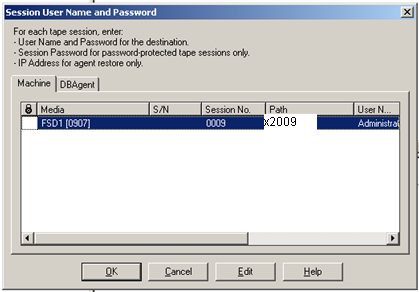

The Security dialog opens.
The Session User Name and Password dialog opens.
