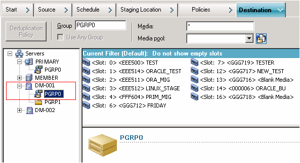

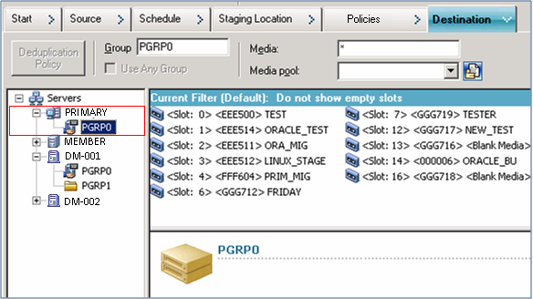

The above migration jobs can be submitted via the primary server or the data mover server. Migration jobs execute from the primary server or the data mover server based on the method used to specify the final destination media.
Example: Server that Executes Migration Jobs
The examples that follow describe the server that executes migration jobs.
