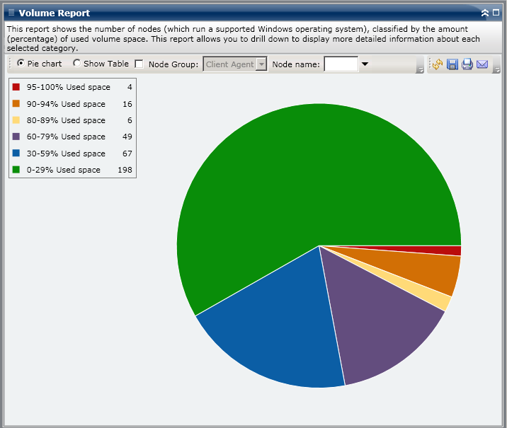

The Volume Report is displayed in pie chart or table format. This report contains filters for Node Group, Node Name, and Node Tier.
Pie Chart
The pie chart shows the amount of volume space used in preconfigured percentage categories.
Show Table
If you select Show Table, the Volume Report displays more detailed information in table format, listing the Node Name, OS, Mount Point, Cluster Size, Volume Size, Free Space, Free Space Percentage, Volume Type, Disk Name, Compressed, File System Type, and Total Fragmentation for all of the allocated space categories.
