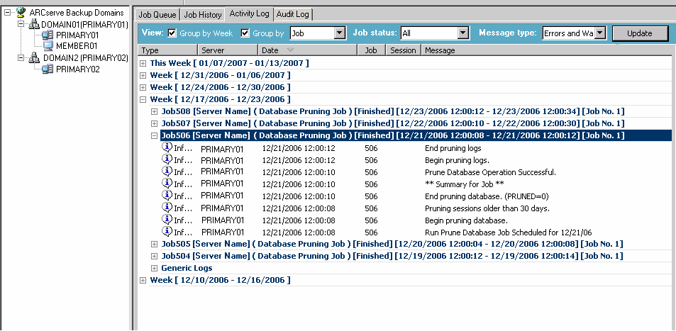

The following diagram illustrates that the Central Management Option is installed, domain member server MEMBER01 is selected, and the activity log details for the MEMBER01 display.
Group by Week (if checked) is always the first level group. The date comes from the operating system's setting.
The format for the week node is as follows:
Week[start date - end date]
The format for the job node is as follows:
JobID [Server Name](Job Name)[Job Status][Start time - End time][Job No.]
The Generic Log appears at the end of the master job list. It contains the logs that do not belong to any job.
