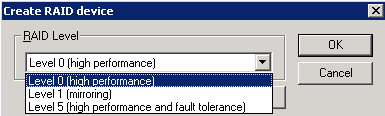

    The Change RAID properties dialog opens.
    Create RAID Device dialog. Level 0 (high performance) is selected.
  4. Click More.
    Change the properties for the selected device and click OK.
