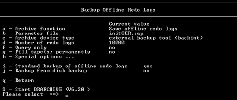

- Ensure that SAPDBA is in archive log mode and that automatic archive is enabled.
- Enter i—Backup offline redo logs.
The Backup Offline Redo logs screen opens.
- Enter e—Archive device type, at the Backup archive logs screen.
The Select archive device type screen opens.
- Enter g—util_file_online, at the Archive device type screen. This is the only archive device type you can select when using SAPDBA for archive redo log backup.
- Enter q—to return to the previous menu.
- Enter g—Number of redo logs. When prompted, enter the number of redo logs.
- Enter q— to return to the previous menu.
- Enter s—Start BRARCHIVE.
