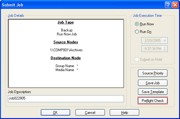

Before submitting a job, you can run a Preflight Check clicking the Preflight Check button on the Submit Job dialog.
