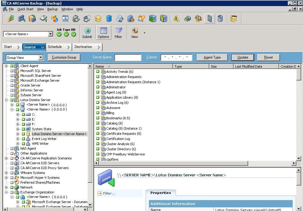

  1. Click Quick Start, Backup.
    The Backup Manager window appears.
  2. On the Source tab, expand the host server that contains the Lotus Domino server that you want to back up.
    The corresponding tree expands to display the servers that you can back up.
    Source Tab

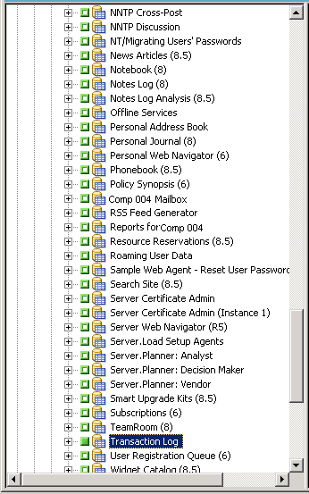

  3. Click the Lotus Domino server that includes the database you want to back up.
    The corresponding tree expands to display a list of databases on the selected Lotus Domino server. In addition, if the Lotus Domino transaction logging option is enabled and the archived transaction logging option is selected, an icon for transaction logs will also be included (alphabetically) in the expanded Lotus Domino tree.
    Tree View
  4. Select the Lotus Domino database by clicking the corresponding marker until it is solid green (full backup).
    You can select the full Lotus Domino server or the individual objects within that server (databases and transaction logs).

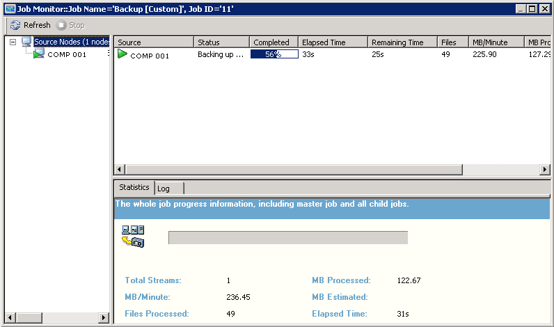

  13. Select the Job Execution Time, choosing either Run Now (to run the backup immediately) or Run On (to define the date and time for the backup) and click OK to submit the backup job.
    The Job Status window appears, displaying the Job Queue and Job Detail. You can view more detailed Job Properties information by right-clicking the server name and selecting Properties. The Job Monitor window appears, displaying details and status of the backup process.
    Illustration showing Job Status with Job Monitor window
    When the backup job is complete, a status window appears, indicating the final status (successful of failed) of the backup job.
