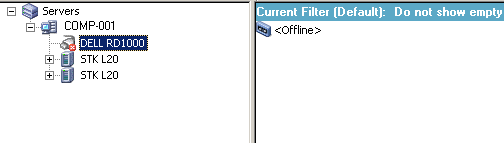

To specify a removable drive as offline
  1. Open the Device Manager window, expand the Servers object.
    Browse to and select the server to which the removable drive is attached.
    CA ARCserve Backup presents you with a list of devices attached to the selected server.
  2. From the list of devices attached to the server, select and right-click the removable drive that you want to take offline.
    From the pop-up menu, select Offline.
    CA ARCserve Backup prompts you to confirm that you want to take the removable drive offline.
  3. Click OK.
    The removable drive is now in an offline state in the Device Manager window.
Note: After you mark the removable drive as offline, <Offline> displays in the Device Manager window.
Device Manager window with an offline library drive.
