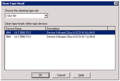

  1. Click the Clean toolbar button.
    The Clean Tape Head dialog opens.
    Clean Tape Head dialog. The cleaning tape slot and the device are specified.
    Note: Offline drives do not appear in the Device Name and Description lists.
  2. From the Choose the cleaning tape slot drop-down list, select the cleaning slot that you want to use.
    From the Clean tape heads within tape device list, select the drive whose head you want to clean.
    Click OK.
    CA ARCserve Backup cleans the tape heads.
