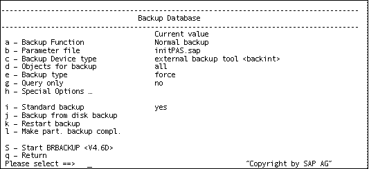

The Backup Database screen displays.

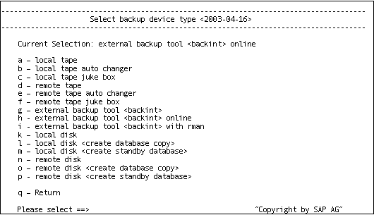

The Select backup device type screen displays.

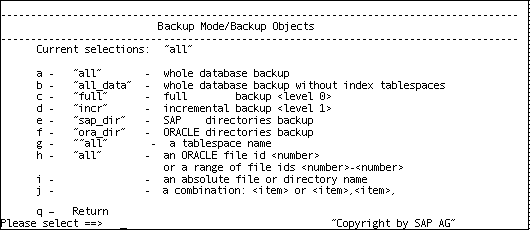

The Backup Mode/Backup Objects screen displays.
The back up starts.
