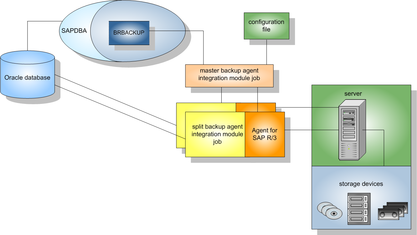

The following diagram illustrates how the option processes information by performing parallel jobs, without interrupting other SAP R/3 activities:
Example: How CA ARCserve Backup Backs up Oracle Data Using Multistreaming

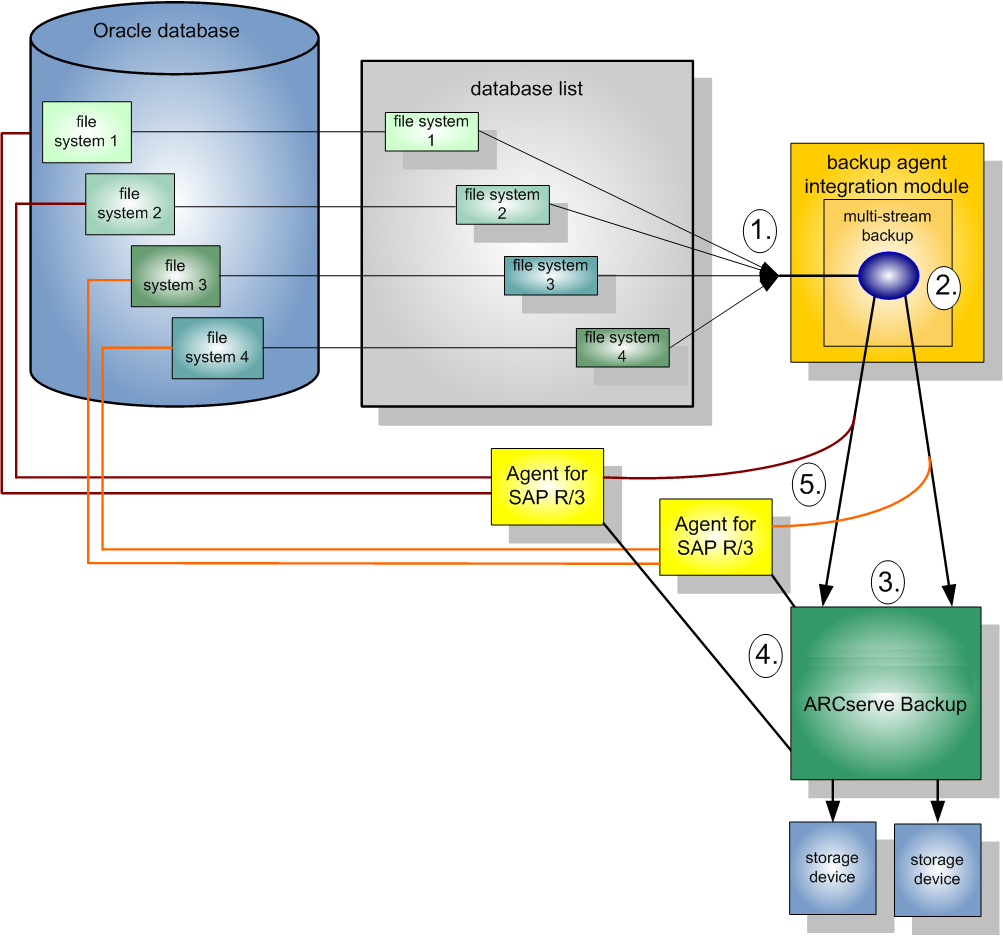

The following example illustrates data on four file systems being backed up to two storage devices. Because there are two storage devices, two jobs are created for the four file systems. Jobs are split according to the maximum number that you set in the MAXSTREAMS value (in this example, MAXSTREAMS is set to 2).
A backup request triggers the following process:
The following diagram illustrates data on four file systems being backed up to two storage devices:
