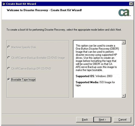

To prepare for a disaster using this method
The Create Boot Kit Wizard dialog opens.
The Select Client Server dialog opens. The dialog has the list of computers and their configurations saved on the CA ARCserve Backup server. This pane is empty when the ARCserve server does not back up a computer.
Create Boot Kit Wizard with options opens.
Note: This option is not enabled if a bootable tape drive is not detected.
