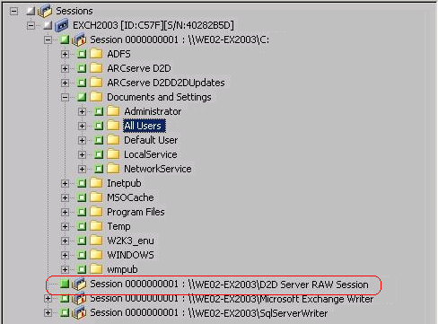

  3. Locate the CA ARCserve D2D server containing the raw session that you want to recover.
    Restore Manager, Session tree. The raw backup session is specified.
    Click the check box next to the raw session.
