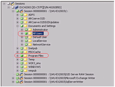

Expand the server that you want to recover and locate the session from which you want to recover data at file level granularity.
Next, click the check boxes next to the files, folders, or directories that you want to recover, as illustrated by the following screen:
