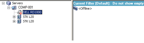

Use the Offline removable drive option when you want to perform maintenance, repairs, or detach a drive from your CA ARCserve Backup environment. For example:
Important! When the removable drive is offline, jobs associated with the removable drive may fail.
To specify a removable drive as offline
Browse to and select the server to which the removable drive is attached.
CA ARCserve Backup presents you with a list of devices attached to the selected server.
From the pop-up menu, select Offline.
CA ARCserve Backup prompts you to confirm that you want to take the removable drive offline.
The removable drive is now in an offline state in the Device Manager window.
Note: After you mark the removable drive as offline, <Offline> displays in the Device Manager window.
