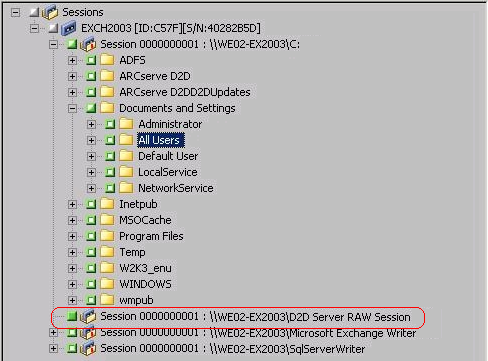

The sessions appear in the Session tree.
Click the check box next to the raw session.
