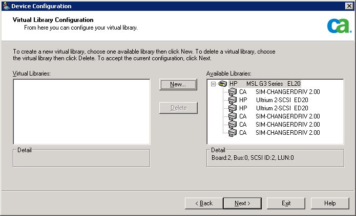

  3. In the first Virtual Library Configuration dialog, select the Mixed Media Library. Click New to access the New Virtual Library Properties dialog.
    Virtual Library Configuration. Devices display in the Available Libraries field.

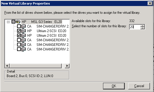

  4. From the New Virtual Library Properties dialog, select the drives that use the same media type and also select the corresponding slot range that will hold that media type. Click OK to continue.
    New Virtual Libraries Properties dialog. Devices appear in the available devices list.
    Note: The slot range specified is in sequential order, beginning with the first slot in the library. Make sure that you select the drives having the same media type as the media in the first slot range.

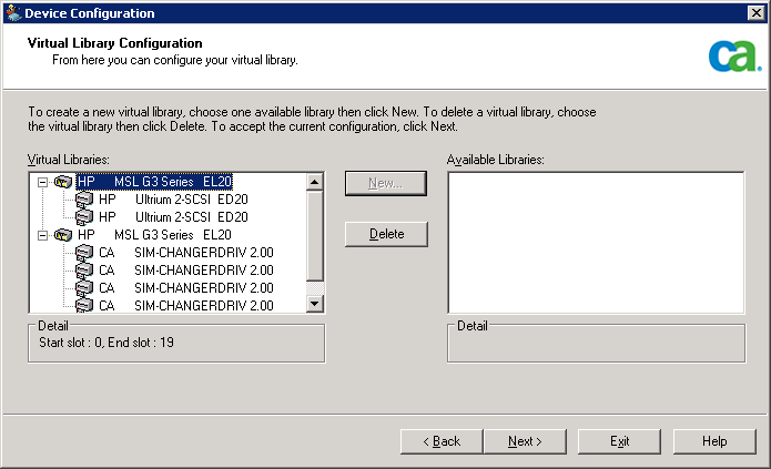

  5. Repeat Steps 5 and 6 for each set of drives that use the same media type.
  6. Click Next.
    Device Configuration.  Virtual Library Configuration dialog. The available libraries display in the Virtual Libraries field.
    You have successfully configured a mixed media, CA ARCserve Backup virtual library.
