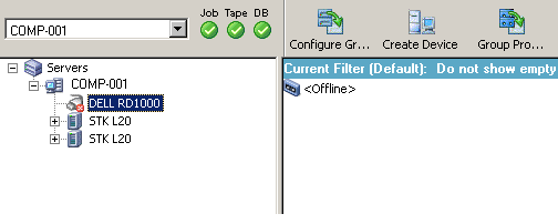

Note: After you mark the removable drive as offline, <Offline> displays in the Device Manager window as illustrated by the following:
Device Manager window with an offline library drive.
