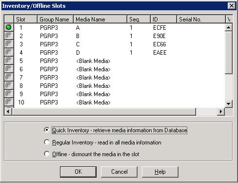

To inventory slots
- Right-click a slot and select Inventory/Offline Slots from the pop-up menu.
The Inventory/Offline Slots dialog opens.
- Select the slot you want to inventory. Press the Shift key to select multiple contiguous media. Press the Ctrl key to select multiple non-contiguous media. The light icon next to selected media turns green.
Note: You can also click and drag the light icon to select multiple contiguous media.
- Choose one inventory method:
- Click OK.
CA ARCserve Backup inventories the slots.
