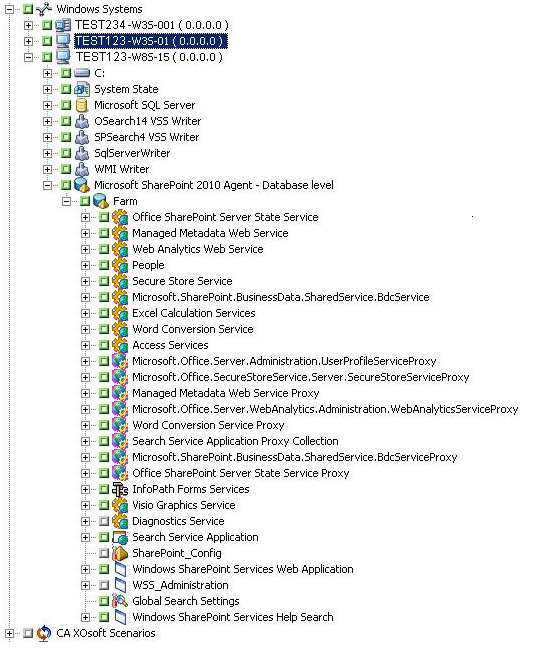

    SharePoint Farm in Server 2010
  2. From the Backup Manager window, select the Database-Level objects you want to back up (Microsoft SharePoint 2010 - Database level). If you want to back up only certain components in the farm, expand the farm and select the components.
  3. Right-click the Farm object you are including in this job and select Agent Option to select a backup method to use and click OK.
