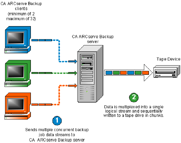

Flow Diagram - Multiplexing
Note: When using multiplexing, you can select the maximum number of streams that can write to a tape at the same time. For more information, see Specify Multiplexing Options.
