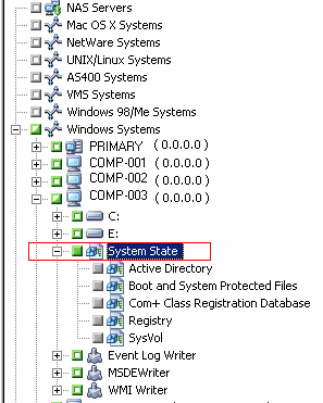

  3. Browse to the computer that you want to back up.
    Expand the volumes contained by the server and display the System State object.
    Click the check box next to System State.
    Note: The Backup Manager prevents you from selecting only the Active Directory.
