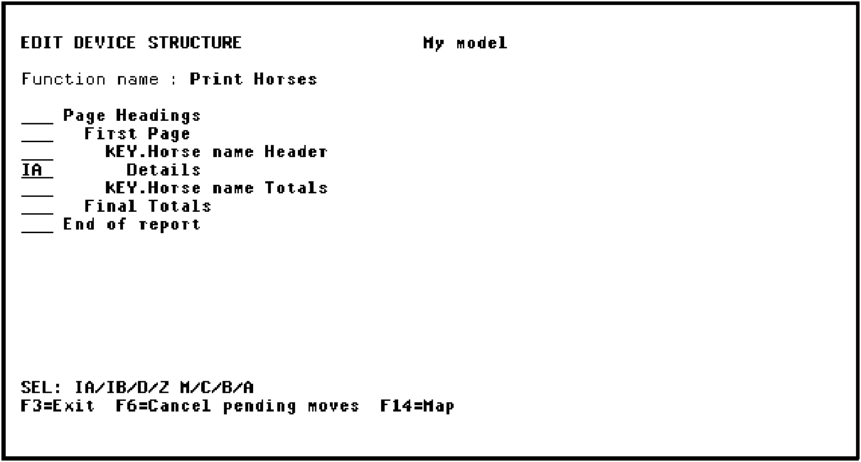

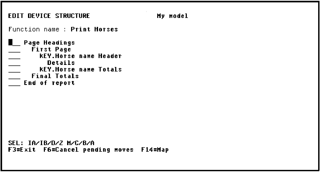

The next step is to combine the two functions so that the records from the Print Object function (each race entry) will be printed after each detail record in the Print File function (after the horse to which it applies). To do this, you will use the Edit Device Structure panel.
Type T against the Print Horses function.
Press Enter.
