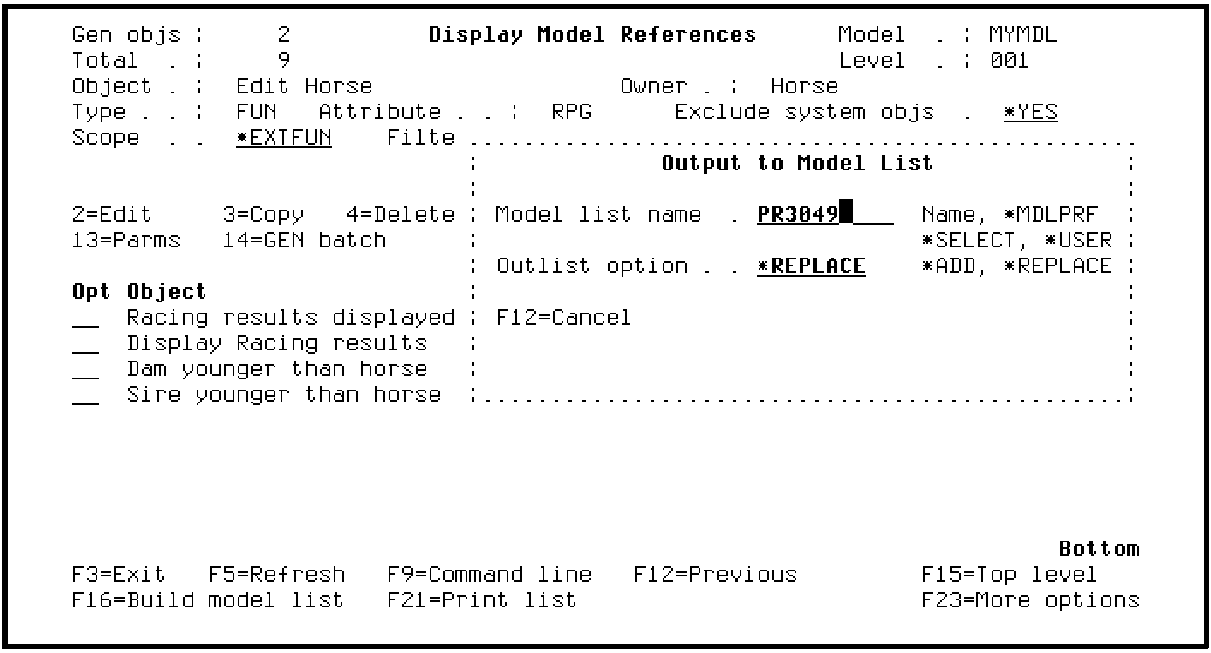

Naming the List of References
You should assign a name to the list that will be meaningful to the development staff. By default the model list name is the Model list for commands specified in your model profile.
Press F16 to display the window where you will enter the name of the model list that is to contain the references. Suppose you are responding to Problem Report 3049; as a result, you might name the model list PR3049.
Type PR3049 in the Output to Model List window.
Press Enter. Notice the messages at the bottom of the window as the references are converted to entries on the model object list. On return to the Display Model References panel a message at the bottom of the panel verifies that the conversion is complete.
