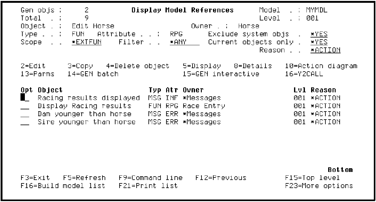

Displaying Only External Functions
Since you are using references to solve a problem in an application program, you only need to see external functions that are referenced in the Edit Horse action diagram.
Type *EXTFUN for the Scope field and type *ACTION for the Reason field.
Press Enter. Only the functions that make up the program in which the error occurred are now displayed. In a working model this list would generally be much longer. This is a useful starting place for the developers whose task it is to fix the problem.
