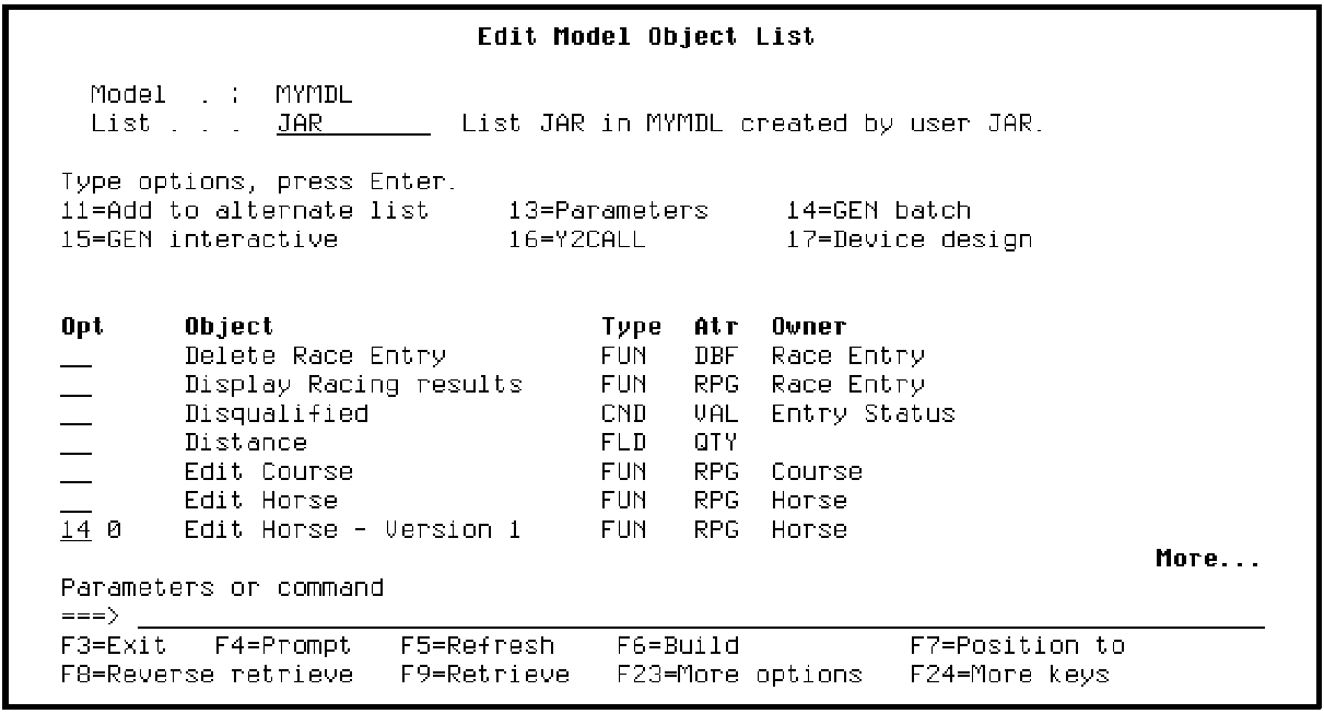

Submitting the Function Version for Generation
You can submit generation requests and process job lists directly from the Edit Model Object List panel. Press F23 to see additional Subfile selector options. The appropriate option for submitting access paths and functions for batch generation is 14.
Type 14 in the Subfile selector for the Edit Horse - Version 1 function.
Press Enter. A message at the bottom of the panel indicates that the request for batch generation has been submitted.
