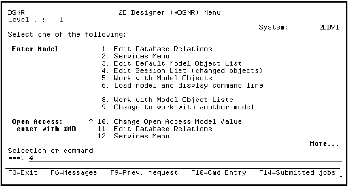

From the CA 2E Designer (*DSNR) Menu, select the Edit Session List (changed objects) option.
Press Enter.
The Edit Model Object List panel displays showing all model objects you changed during the tutorial.
