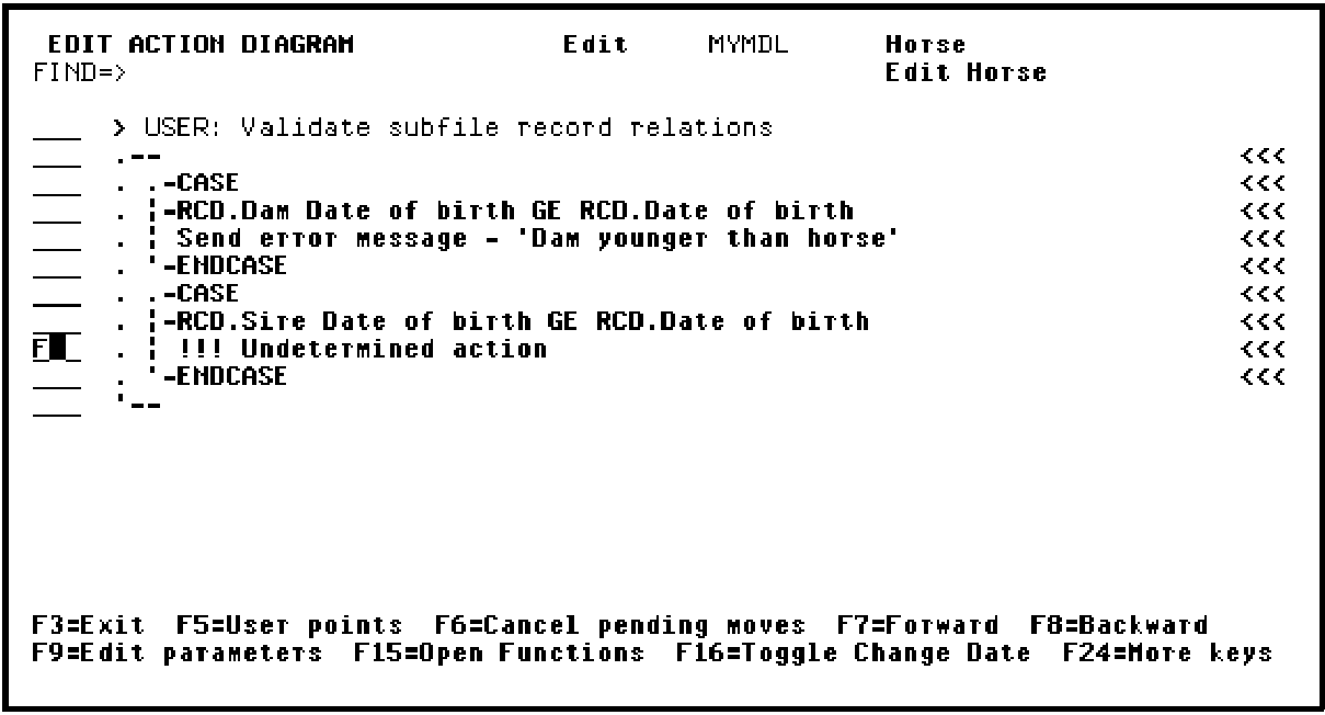

In this step you will define the message function to be called when the sire is younger than the horse. The entire process will take place within the action diagram. Note that you could have defined both message functions in this way.
Type F against the second !!! Undetermined action.

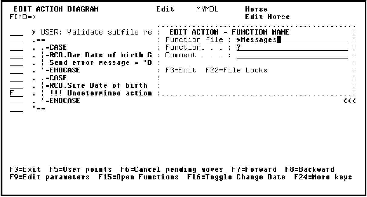

Press Enter. A blank Edit Action - Function Name window displays as before. Type *Messages for the Function file field as shown. Leave the ? in the Function name field.
Press Enter.
