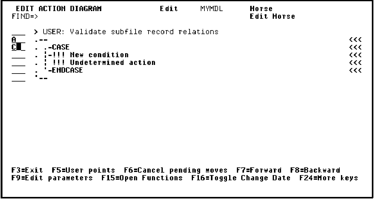

In this step you will add a second condition to validate a horse’s date of birth with respect to that of its Sire. You can use the same process you used in the previous step or you can copy the first construct. In this case you will copy the first construct.
Type A on the line above the location where you want the construct copied; type C next to the first line of the construct you want to copy.
Press Enter.
