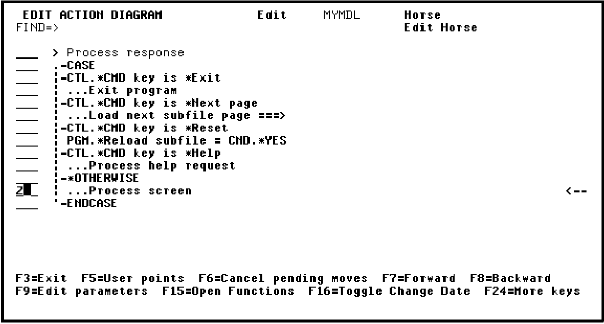

The Process Response Construct
The Process response construct is now displayed. It is made up of four mutually exclusive actions based on which function key was pressed. For example, the Exit key exits the program, the Next page key loads another subfile page, and the Reset key reloads the subfile page to process the input data. In this case, you will zoom into the hidden ...Process screen construct.
Type Z against ...Process screen.
Press Enter.
