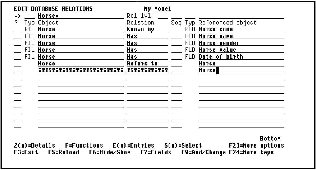

If you have not already done so, type Horse* on the selection line on the Edit Database Relations panel to display only the relations that define the HORSE file. Press Enter.
You are now ready to add the relations that define the horse’s parents. To add references to a horse’s parents type the Horse Refers to Horse relation twice; once for the Dam and once for the Sire. Type the HORSE Refers to HORSE relations.
Press Enter.
