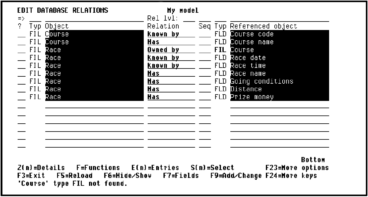

After pressing Enter, the relation statements you have entered are redisplayed, with any use of the DUP key resolved. All new objects, for example, files and fields, are highlighted in reverse image to indicate that you have not yet defined them. An error message for the first undefined item "’Course’ type FIL not found" is displayed at the bottom of the panel.
You will use the F10 key to define the objects you just entered. First, press F24 to display more function keys.

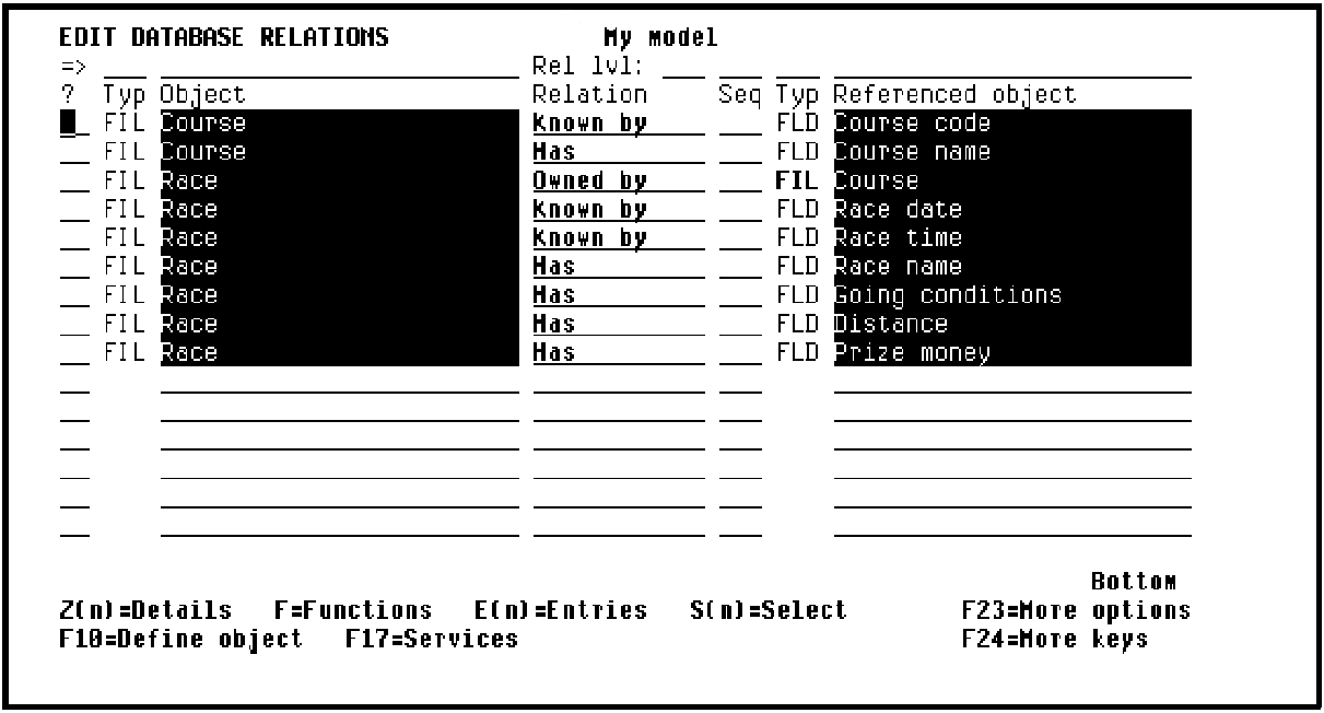

Press F10 to display the Define Objects panel where you will enter the details needed to define the objects.
