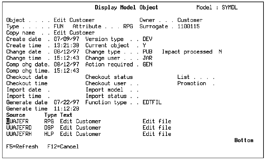

Viewing a Model Object Description
From the Edit Model Object List panel, enter 8 to display a model object's description from the All Objects list. You can also use the Display Model Object Description (YDSPMDLOD) command. The following panel displays:
A standard set of information is displayed for each type of model object. Additional information displayed varies according to the type of model object.
