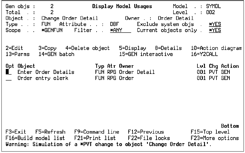

  2. To simulate a private change, enter option 94 for the object you want to change on either the Display Model Usages panel or the Display Model References panel.
    In this case,CA 2E expands usages for the object to be changed up to the first external function in each sequence of usages. Suppose the object to be changed is the Change Order Detail function.
    The following panel displays:
    Note that only those objects that need to be generated to implement the proposed change are displayed, not all usages. GEN in the Action column indicates that the model object will need to be regenerated when you make the proposed change.

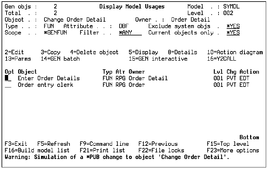

    To simulate a public change, enter option 95 for the object you want to change on either the Display Model Usages panel or the Display Model References panel.
    As for a private change,CA 2E expands usages for the object to be changed up to the first external function in each sequence of usages. In addition, it identifies objects that need to be edited as a result of the proposed change. Suppose the object to be changed is the Change Order Detail function.
    Note that only those objects that need to be edited or generated to implement the proposed change are displayed, not all usages. EDT and GEN in the Action column indicate that the corresponding model object needs to be either edited or regenerated when you make the proposed change.
