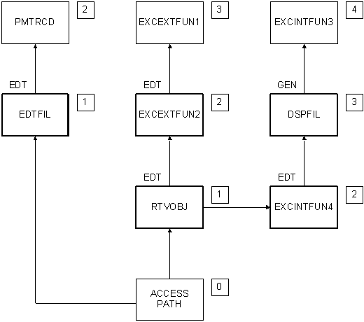

Suppose you intend to add or remove a relation for Access Path using the Edit Access Path Relations panel.CA 2E considers this to be a public change. As a result CA 2E :
- Expands usages of Access Path until the first external function on any given sequence of usages is encountered as it did for the private change. However, for a public change the level at which each using object occurs is significant.
- Sets the Required action indicator to EDT in the All Objects list for all using objects that occur at level 1 to indicate that they require editing as a result of the change. Specifically:
- Public change to Access Path is a private change to EDTFIL and it needs to be edited (Required Action=EDT).
- Public change to Access Path is a public change to RTVOBJ, because it is used for a parameter definition, and it needs to be edited (Required Action=EDT).
These are shown in the diagram by the letters EDT and the small box containing a 1.
- Checks the model objects at level 2. The result depends on the way in which the level 1 object uses Access Path. In this example the RTVOBJ function uses Access Path as the based on access path and for parameter definition. Specifically:
- Public change to RTVOBJ is a private change to EXCEXTFUN 2; it needs to be edited to accommodate the change to RTVOBJ's parameters (Required Action = EDT).
- Public change to RTVOBJ is a private change to EXCINTFUN 4 and it needs to be edited (Required Action = EDT).
These are shown in the diagram by the letters EDT and the small box containing a 2.
- Repeats the process for the model objects at level 3. The private change to EXCINTFUN 4 is a private change to the external DSPFIL function and it needs to be generated (Required Action = GEN).
- Repeats this process for each usage level until an external function is encountered.
