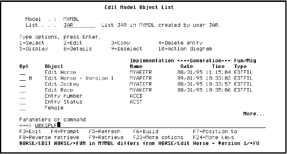

Use the i OS Work with Spool Files (WRKSPLF) command to view the differences. Type WRKSPLF on the Command line.

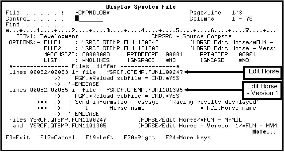

Press Enter. Use Subfile selector option 5 to display the job named YCMPMDLOB$. The differences are shown as follows.
Press F3 twice to return to the Edit Model Object List panel.
