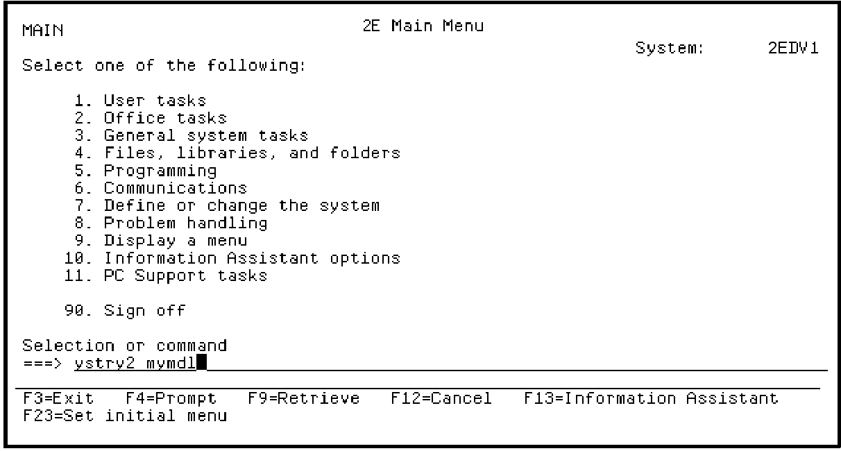

To enter CA 2E, type the Start CA 2E (YSTRY2) command, specifying the name of your CA 2E design model as the LIBLST parameter from any i OS Command Entry line:
YSTRY2 MYMDL
Type the command as shown.
Press Enter.

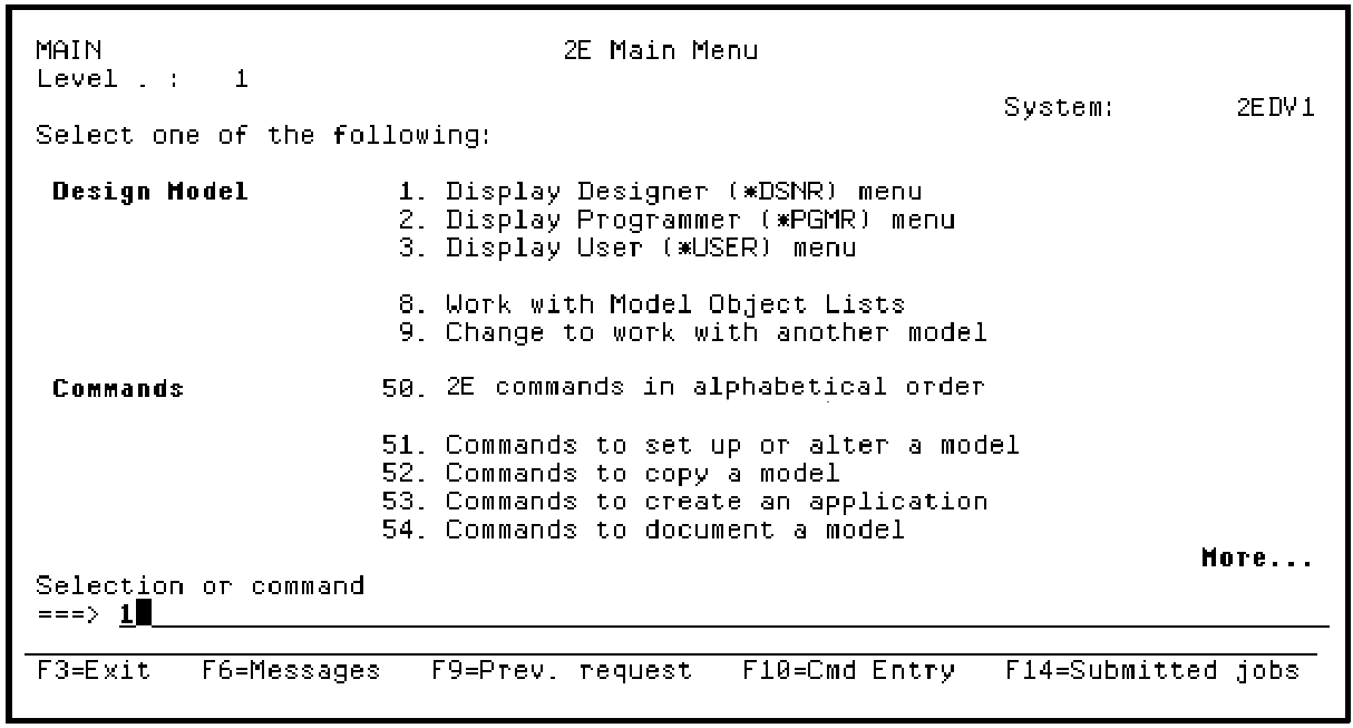

The CA 2E Main menu appears. The first panel of the CA 2E Main Menu provides a set of Design Model options and access to CA 2E commands grouped according to function.
Type 1 in the command entry line as shown to display the CA 2E Designer (*DSNR) Menu.
Press Enter.

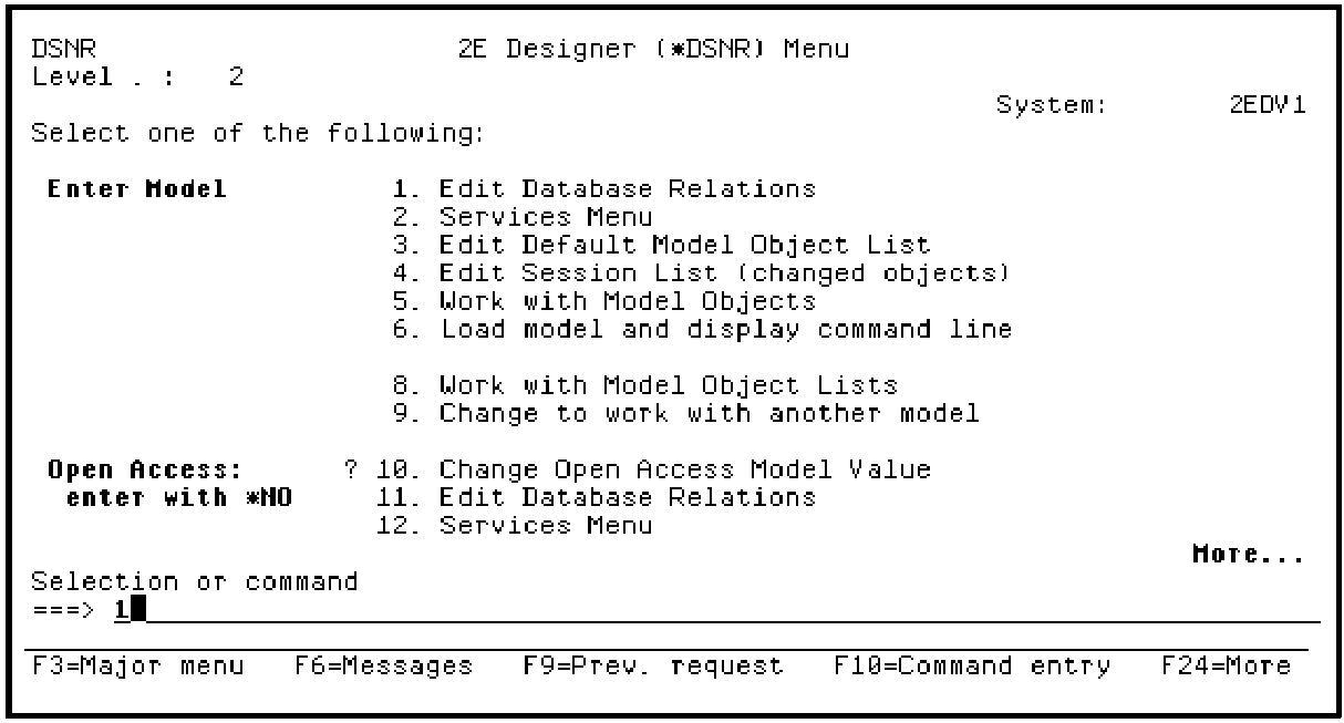

The first panel of the CA 2E Designer (*DSNR) Menu displays. This menu provides a list of tasks available to users with *DSNR authority. Type 1 in the command entry line as shown to enter your CA 2E design model for editing.
Press Enter.

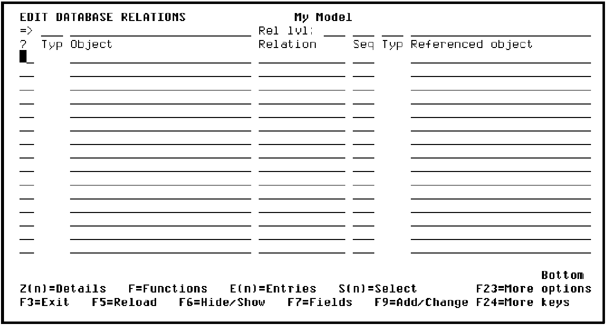

When it is finished the Edit Database Relations panel will appear.

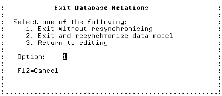

It is unlikely that you will complete the tutorial in a single session. If at any time you want to leave your CA 2E design model, you can do so by pressing F3 repeatedly until you return to the Edit Database Relations panel
At that point, press F3 again to display the Exit menu. Press F3 now for practice.
Normally when you exit your design model, you will accept the default option and press Enter. However, if you plan to continue with the tutorial, type 3 instead of accepting the default to continue your editing session and press Enter. This returns you to the Edit Database Relations panel.

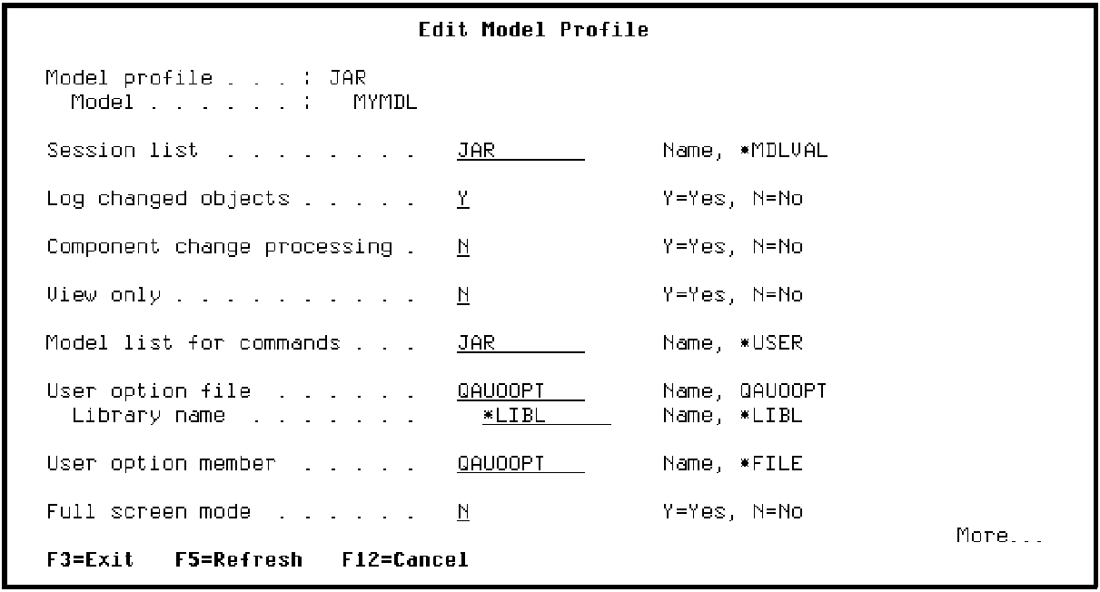

Your model profile establishes the basic working environment for your interactive session. CA 2E automatically creates a model profile for each user that is granted access to a model. Before beginning work on your CA 2E model, you need to check, and possibly override, the default settings in your model profile.
Note: You need to do this step before you enter any information for your tutorial design model and you only need to do it once.
This process assumes that the Edit Database Relations panel is displayed on your screen. If not, re-enter your model as explained previously using the Start CA 2E (YSTRY2) command.

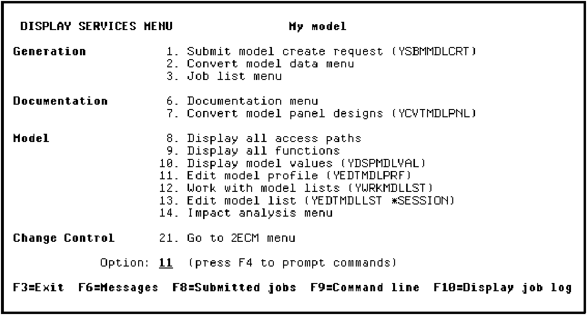

One way to access your model profile is by using the Display Services Menu. This menu is an important CA 2E tool that gives you access to many CA 2E support functions while you are working on a model. From the Edit Database Relations panel, press F17 to access the Display Services Menu This function key is available from many CA 2E panels.
From the Display Services Menu, type 11 in the Option field to Edit your model profile.
Press Enter to display the first screen of the Edit Model Profile panel.
The model profile lets you define defaults for various processes and file specifications for an interactive session. Notice that the default value for the Session list field is your user profile name. Also, check that the value of the Log changed objects field is Y. If it is not, type Y.
Press Enter.
