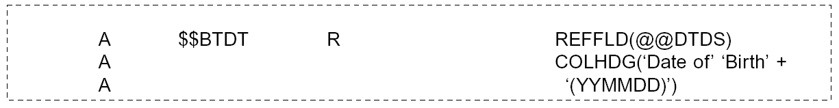

When the field is of a standard type, for example, already defined as a primary field, the field should be defined by reference to its primary field—that is to say using REFFLD(*SRC). In such cases, only the column headings need to be redefined.
Fields should only be defined with reference to a type field when there is a genuine dependence. A simple test of this is to ask the question: If I were to change the definition of the based-on field, would I want the definition of the dependent field to change as well?
When appropriate (for example, for total fields) use relative lengths (+-)n to increase or decrease field lengths with respect to the based-on field.
Each field should be fully defined with edit codes/words, text, ranges, values, display attributes, etc. Use the DDS COLHDG keyword rather than the TEXT keyword as it provides neater documentation.
