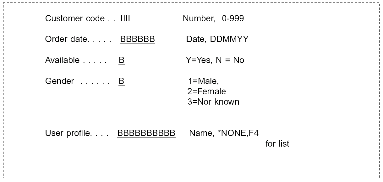

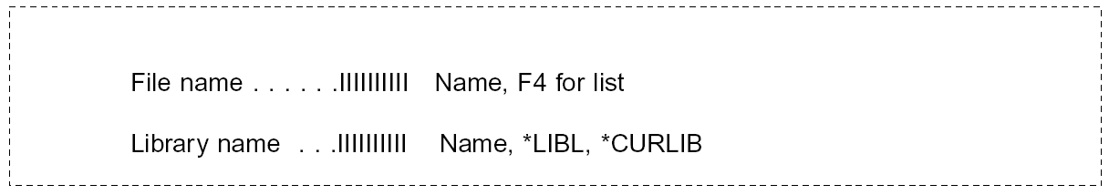

Place dot leaders to connect field text with fields. On iSeries, these should be double spaced and only end in a colon if the field is protected. Leave as much space as possible to allow for expansion in translation. Align fields by using a standard text length. For example:
For input fields, provide right-hand side text to explain the allowed values. This should have the form, "general domain, valuen=explanation". Indicate if a selection is available. Place the default value first as shown in the following image:

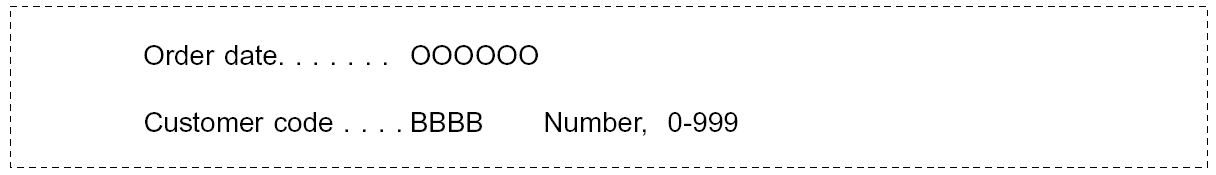

The overall aim is to give a greater emphasis to input-capable fields than to output-only fields, and the greatest emphasis to input-capable fields for which an error has been detected, as shown in the following example:

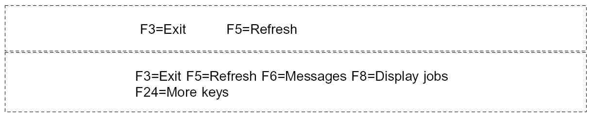

Place text giving a summary definition of command key meanings at the bottom of the display (line 23, or lines 22 and 23). Precede each key explanation with Fn=. Double-space the key explanations without punctuation. If there are more command key explanations than will fit on the available space, use F24 to display the extra values.
For example:
You may also use F11 to condition the introduction of extra detail fields.
