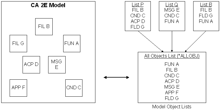

The following diagram illustrates the model object list and its relation to the CA 2E model.
As shown in the diagram, model object lists can include model objects of different object types. You can use a model object list to group related objects into a set in the same way application areas let you group files. This enables you to manipulate or process a set of model objects with a single command or to easily process a series of tasks required as a result of a change to your model.
