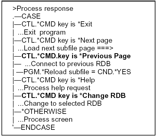

For functions to be distributed with S (CA 2E) for Distributed File I/O Control, the default action diagram of those functions will show the availability of the *Change RDB function and, depending on the function type, the *Previous page function. For example:
