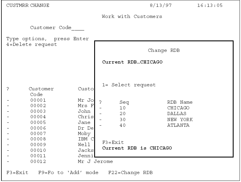

All functions generated under S (CA 2E) control enable function key F22 for their device designs. The default value of this key is stored in a *Change RDB command key list, and can be modified in the model. Function key F22 calls the shipped CA 2E program Y2CRDBR (Change RDB), which appears in a window. The program displays all RDBs in the configuration table for the primary view and allows application users to switch to an RDB by merely selecting one of the entries. This program indicates to users which RDB they are currently connected to.
For example:
