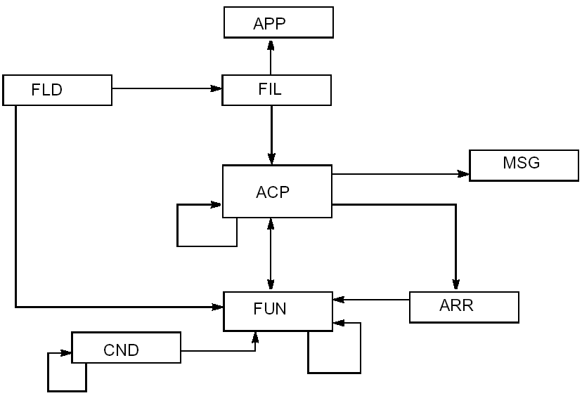

The usages for a model object are all the model objects that use it (or all model objects it is used by). In other words, usages for a given model object are the model objects that require it in order to be complete and are external to the model object. A model object's usages are sometimes referred to as using objects. The following diagram shows the possible usages for each CA 2E model object type:
For example:
Note: There is no direct relationship between fields (FLD) and access paths (ACP). In other words, a change to a field does not directly affect the access paths that use it.
For more information on the note and the possible ways a given model object type can be used by other model objects types, see the CA 2E Command Reference Guide.
